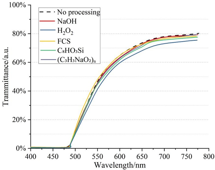

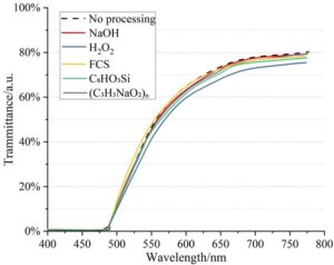

Figure 1 shows the changes in transmittance of TC4 coated with a SiO\(_2\) layer before and after 72 hours of UV irradiation, following surface modification using different methods. As shown in the figure, except for the TC4 substrate pretreated with H\(_2\)O\(_2\) solution, which exhibited a slight decrease in transmittance, the transmittance of TC4 coated with SiO\(_2\) after surface modification using the other four methods remained unchanged after 72 hours of irradiation. This indicates that the coating samples prepared using NaOH, H\(_2\)O\(_2\), FCS, C\(_8\)HO\(_3\)Si, and (C\(_3\)H\(_3\)NaO\(_2\))\({}_{n}\) chemical treatments maintained good optical properties and demonstrated a certain degree of resistance to UV irradiation after 72 hours of UV exposure.

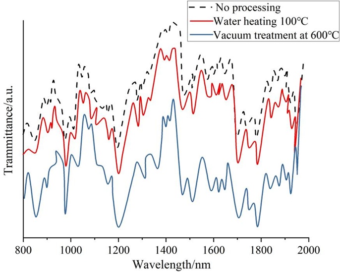

3.2.2 FTIR analysis after heat treatment
Figure 2 shows the FTIR spectra of TC4 before and after hydrothermal treatment and vacuum treatment. From the curves in the figure, it can be observed that after 1 hour of hydrothermal treatment at 100\(\mathrm{{}^\circ}\)C, the characteristic absorption peaks of the imine ring, including the carbonyl stretching vibration peak at 1017 nm, the C-N stretching vibration peak at 1434 nm, and the aromatic ring stretching vibration peaks at 1910 nm, 1933 nm. This indicates that the overall structure of TC4 remains unchanged under these hydrothermal conditions and after vacuum treatment at 600\(\mathrm{{}^\circ}\)C.
During vacuum heating treatment at 600\(\mathrm{{}^\circ}\)C, the thickness of the oxide layer on the surface of the TC4 substrate was only one-fifth of that obtained under air treatment. This dense oxide film significantly enhances the material’s corrosion resistance in marine environments. High-frequency induction heat treatment technology, through rapid heating and controlled cooling, can form a nanocrystalline layer on the surface of titanium alloys.

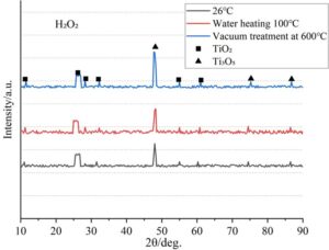

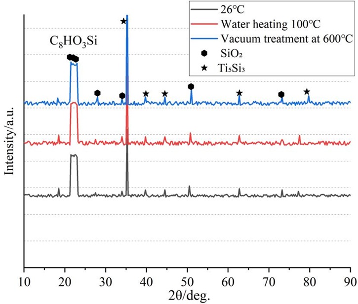

3.3.1 XRD phase analysis under different chemical treatments

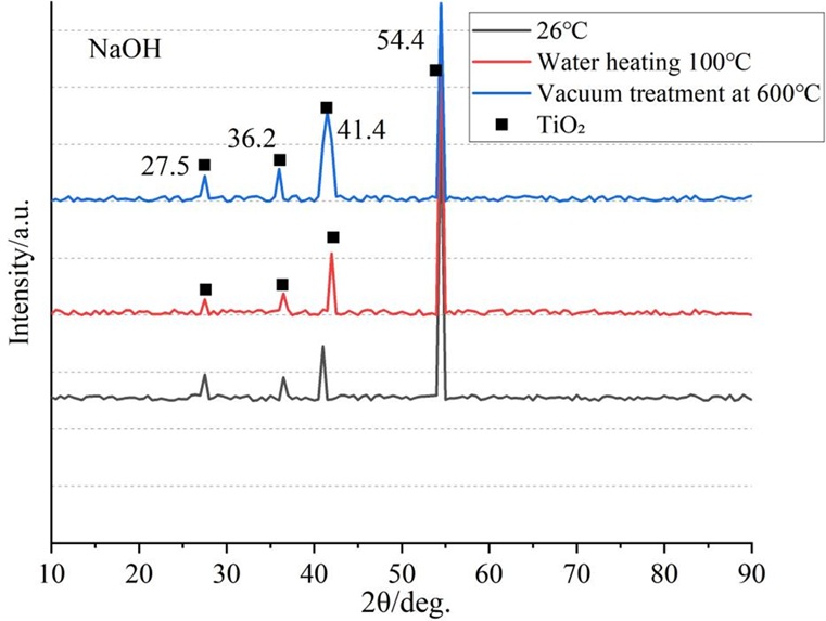

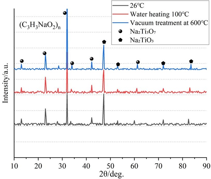

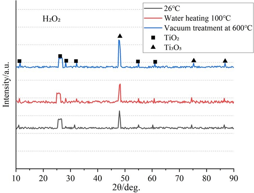

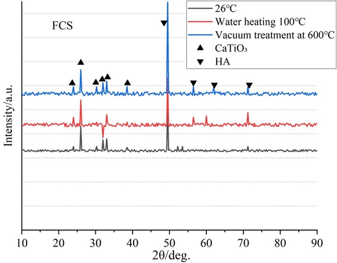

The TC4 titanium alloy treated with five solutions—NaOH, H\(_2\)O\(_2\), fast calcium solution (FCS), vinyl triethoxysilane (C\(_8\)H\(_3\)Si), and sodium polyacrylate (C\(_3\)H\(_3\)NaO\(_2\))\({}_{n}\)—was subjected to 200 cycles at room temperature, heat treatment at 100\(\mathrm{{}^\circ}\)C, and vacuum heat treatment at 600\(\mathrm{{}^\circ}\)C. The XRD diffraction patterns obtained are shown in Figures 3–7. It can be seen that the phase composition of the high-temperature alloy before oxidation is \(\gamma\)/\(\gamma\)’ phase for all five solutions, while the phase composition after oxidation shows significant differences.
It can be seen that under NaOH treatment, the main oxidation product is rutile-type TiO\(_2\), with strong peaks at 27.5\(\mathrm{{}^\circ}\) (110) and 36.2\(\mathrm{{}^\circ}\) (101). Characteristic peaks also appear at 41.4\(\mathrm{{}^\circ}\) and 54.5\(\mathrm{{}^\circ}\), indicating that high-temperature cycling promotes the phase transformation from anatase to rutile.
Under H\(_2\)O\(_2\) treatment, the oxidation products are amorphous TiO\(_2\) + Ti\(_3\)O\(_5\). The 25.6\(\mathrm{{}^\circ}\) broad peak is characteristic of amorphous TiO\(_2\), while the 48.2\(\mathrm{{}^\circ}\) peak corresponds to Ti\(_3\)O\(_5\). The loose H\(_2\)O\(_2\) oxide film leads to the formation of some sub-stoichiometric oxides.
The oxidation products under FCS treatment are CaTiO\(_3\) and hydroxyapatite Ca\(_{10}\)(PO\(_4\))\(_6\)(OH)\(_2\). The 33.2\(\mathrm{{}^\circ}\) peak corresponds to the CaTiO\(_3\) (121) crystal plane, while the 25.9\(\mathrm{{}^\circ}\) and 31.8\(\mathrm{{}^\circ}\) peaks correspond to the (002) and (211) crystal planes of HA, respectively. FCS pre-calcination promotes the formation of the perovskite structure.
The oxidation products of vinyl triethoxysilane are amorphous SiO\(_2\) + Ti\(_5\)Si\(_3\). The 22\(\mathrm{{}^\circ}\) broad peak corresponds to the amorphous characteristic of SiO\(_2\), while the 35.5\(\mathrm{{}^\circ}\) peak corresponds to the Ti\(_5\)Si\(_3\)(112) crystal plane. At high temperatures, Si reacts with Ti to form silicides.
The products obtained under sodium polyacrylate treatment are Na\(_2\)Ti\(_3\)O\(_7\) and Na\(_2\)TiO\(_3\). The characteristic peaks of Na\(_2\)Ti\(_3\)O\(_7\) are at 23.8\(\mathrm{{}^\circ}\) (110) and 32.7\(\mathrm{{}^\circ}\) (020), while the peak at 47.1\(\mathrm{{}^\circ}\) is attributed to Na\(_2\)TiO\(_3\). Na\(^+\) ions are embedded into the titanium oxide structure to form layered compounds.
The antioxidant activity ranking is FCS \(\mathrm{>}\) silane \(\mathrm{>}\) NaOH \(\mathrm{>}\) sodium polyacrylate \(\mathrm{>}\) H\(_2\)O\(_2\). The FCS group forms a dense CaTiO\(_3\)/HA composite layer, resulting in the slowest decrease in \(\gamma\)-Ti peak intensity (lowest oxidation level); the H\(_2\)O\(_2\) group shows nearly complete disappearance of the \(\gamma\)-Ti peak, with the weakest protective properties of the amorphous oxide layer. High-temperature phase stability is reflected in the enhanced Ti\(_5\)Si\(_3\) peak at 600\(\mathrm{{}^\circ}\)C in the silane-treated group, with silicates inhibiting oxygen diffusion.

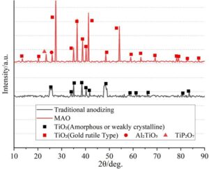

3.3.2 XRD phase analysis under electrochemical treatment
The aforementioned analysis focuses on the effects of chemical treatment and heat treatment on phase composition. Correspondingly, as an important surface modification technique, the phase composition of the coatings induced by electrochemical treatment also requires detailed analysis.

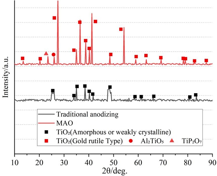

The XRD diffraction patterns of the alloy treated with traditional anodization and micro-arc oxidation (MAO) are shown in Figure 8. Before oxidation, both coatings consist of a saturated single \(\gamma\) phase, with other elements present in the \(\gamma\) phase in the form of solid solutions.
Under conventional anodization, the main product is amorphous or weakly crystalline TiO\(_2\) (primarily the anatase phase), characterized by broadened peak widths and low intensity, with typical peaks at 25.3\(\mathrm{{}^\circ}\) and 48.1\(\mathrm{{}^\circ}\). The \(\alpha\)-Ti phase of the substrate (with main peaks at 35.1\(\mathrm{{}^\circ}\), 38.4\(\mathrm{{}^\circ}\), and 40.2\(\mathrm{{}^\circ}\)) remains significantly present, indicating a thin oxide film.
Under micro-arc oxidation (MAO), the oxidation products are highly crystalline rutile-type TiO\(_2\), with sharp and high-intensity characteristic peaks, with strong peaks at 27.5\(\mathrm{{}^\circ}\) (110), 36.1\(\mathrm{{}^\circ}\) (101), 41.2\(\mathrm{{}^\circ}\) (111), and 54.3\(\mathrm{{}^\circ}\) (211). Due to the composition of the electrolyte (e.g., containing silicates or phosphates), small amounts of Al\(_2\)TiO\(_5\) (peak at 26.1\(\mathrm{{}^\circ}\)) or TiP\(_2\)O\(_7\) (peak at 23.5\(\mathrm{{}^\circ}\)) may be formed, enhancing the stability of the coating layer. The intensity of the \(\alpha\)-Ti peak is significantly reduced, indicating a thicker and denser oxide film.

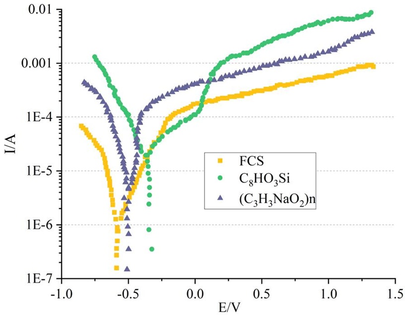

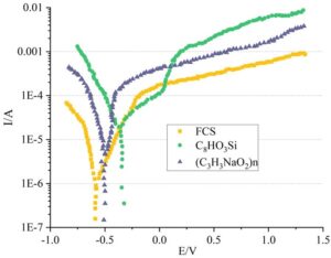

3.4.2 Analysis of the surface potential of the substrate
Studies have shown that immersion in FCS and C\({}_{8}\)HO\({}_{3}\)Si solutions can effectively increase the surface roughness of the substrate, ensuring the adhesion strength of the coating on the substrate surface. However, due to the unique chemical composition of the TC4 titanium alloy surface, the residuals of different solutions on the substrate surface can significantly affect the corrosion resistance of the substrate surface. FCS, \({}_{8}\)HO\({}_{3}\)Si, and (C\({}_{3}\)H\({}_{3}\)NaO\({}_{2}\))\({}_{n}\) solutions, which demonstrated overall superior performance, were used to treat the titanium alloy surface. The surface potential of the treated TC4 titanium alloy was tested. The results of the surface polarization potential tests and the electrochemical characteristics of the substrate surface under the three solution immersion treatments are shown in Figure 9 and Table 3, respectively.
Table 3 Electrochemical characteristic values of the surface of TC4 titanium alloy
FCS C\({}_{8}\)HO\({}_{3}\)Si (C\({}_{3}\)H\({}_{3}\)NaO\({}_{2}\))\({}_{n}\)
Open Circuit Potential (OCP)/V -0.281 -0.173 -0.234
Corrosion Potential/V -0.168 -0.087 -0.121
Corrosion Current (nA/cm\({}^{2}\)) 30.7 4.3 13.9
Passivation Potential/V 0.837 0.876 0.851
Breakdown Potential/V 0.945 0.962 0.952
Passivation Zone Width/V 0.118 0.131 0.124
Passivation Current Density (\(\mu\)A/cm\({}^{2}\)) 1.316 0.451 0.768
The more positive the self-corrosion potential of a metal, the wider the passivation zone, and the more corrosion-resistant the metal. As shown in Figure 9 and Table 3, compared to treatments with FCS and (C\(_3\)H\(_3\)NaO\(_2\))\({}_{n}\), titanium alloys treated with C\(_8\)HO\(_3\)Si solution exhibit superior corrosion resistance. The corrosion potential of C\(_8\)HO\(_3\)Si treatment is the most positive (-0.087 V), the corrosion current is the lowest (4.3 nA/cm\(^2\)), the passivation potential range is the widest (0.131 V), and the passivation current density is the smallest (0.451 \(\mu\)A/cm\(^2\)). Under FCS treatment, the corrosion current (30.7 nA/cm\(^2\)) is significantly higher than that of C\(_8\)HO\(_3\)Si, indicating poorer corrosion resistance. Sodium polyacrylate exhibits an intermediate performance, with corrosion potential (-0.121 V) and current (13.9 nA/cm\(^2\)) between the two, but a narrower passivation range (0.124 V).

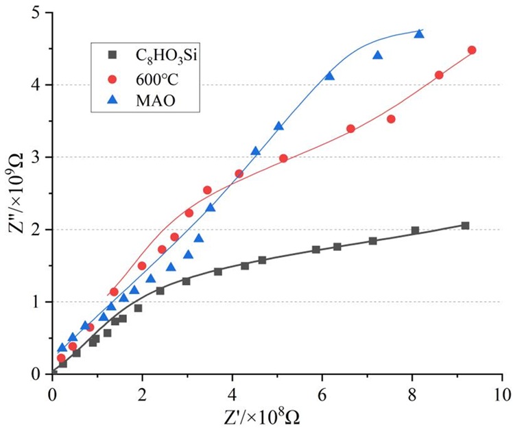

The electrochemical impedance of the coating system determines the penetration and diffusion performance of the corrosive medium within the coating. The higher the electrochemical impedance, the better the coating’s shielding performance against the corrosive medium, i.e., the higher the coating’s corrosion resistance. The electrochemical impedance test results of the coating systems on titanium alloy surfaces under different treatment conditions are shown in Figure 10.
As shown in Figure 10, after 10 days of conventional salt spray testing, the electrochemical impedance of all coating systems remained above 1.0\(\mathrm{\times}\)10\(^9\), indicating that the coatings formed on the surface of TC4 titanium alloy after chemical treatment with C\({}_{8}\)HO\(_3\)Si solution, vacuum heating at 600\(\mathrm{{}^\circ}\)C, and MAO micro-arc oxidation electrochemical treatment all exhibit excellent shielding effects against corrosive media, demonstrating superior corrosion resistance.
