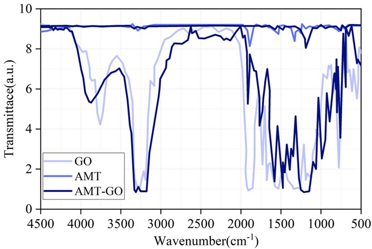

Figure 1 shows the chemical structures of GO, AMT, and AMT-GO powder samples under FT-IR and XPS. Before dispersion and mixing, the absorption peaks of graphene oxide (GO) and thiadiazole (AMT) appear closer to 4500 cm\({}^{-1}\). After mixing and preparation, the absorption peaks of thiadiazole-graphene oxide (AMT-GO) shift toward 500 cm\(^{-1}\). This is primarily due to the reaction of corresponding groups between GO and AMT, resulting in stretching vibrations of the secondary amine group (-NH-). This indicates that the amine groups in AMT have been successfully grafted onto the graphene surface, confirming the successful synthesis of the composite coating.

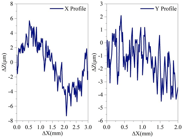

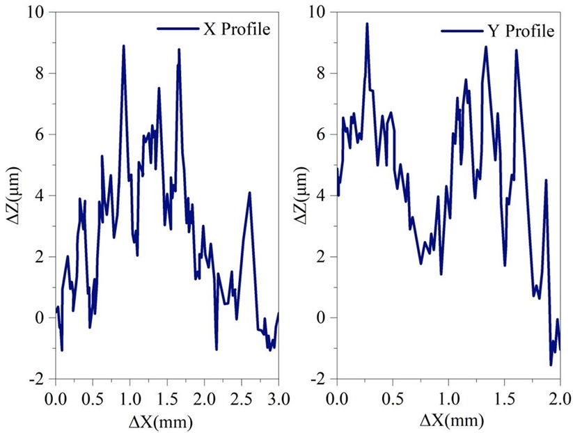

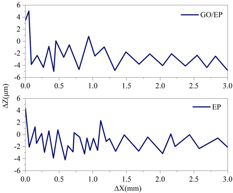

After uniformly applying the synthetic coating to the steel plate and curing it, the AMT-GO/EP organic composite coating used in the experiment was obtained. A microscopic three-dimensional morphology scan was performed on the AMT-GO-modified epoxy coating with 0.02 g of AMT-GO nanofiller added and the as-prepared state. Figure 2 shows the microscopic three-dimensional morphology scan results of the AMT-GO-modified epoxy coating. Figure 3 shows the microscopic three-dimensional morphology scanning results of the final prepared organic composite coating. After adding the curing agent and performing a series of curing operations, the organic composite coating exhibited better dispersion of the maximum height difference (\(\mathrm{\Delta}\)Z) on the coating surface in both the horizontal and vertical directions compared to the original AMT-GO-modified epoxy coating. Specifically, in the horizontal direction, the number of microscopic peaks increased by an order of magnitude within the 0.0–3.0 mm length range; in the vertical direction, the number of microscopic peaks also increased by an order of magnitude within the 0.0–2.0 mm length range. This is because, after curing, the coating provides more uniform protection for the metal steel plate.
3.2.2 Comparison of microstructures of different coatings

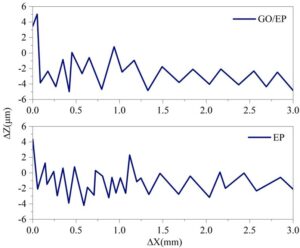

Further scanning of the microstructure of pure epoxy coating (EP) and graphene-modified epoxy coating (GO/EP) was conducted, with the horizontal direction as an example, to compare their dispersion differences with AMT-GO/EP. Figure 4 shows the microstructure of EP and GO/EP in the horizontal direction. In the horizontal direction, the maximum height difference of both comparison coatings is within the range of [-6,6] \(\mu\)m, with a dispersion range smaller than that of AMT-GO/EP ([-8,8] \(\mu\)m), and more significant fluctuations within the horizontal range of 0.0–3.0 mm. This indicates that in terms of dispersion, EP and GO/EP are inferior to AMT-GO/EP.

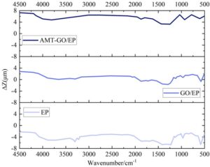

3.3.1 Fourier infrared spectroscopy comparison
During the experiment, the chemical composition of different organic coatings was collected multiple times and subjected to Fourier transform infrared spectroscopy (FTIR) testing to analyze changes in chemical composition during the erosion process, thereby assessing the protective efficacy of the coatings on the metal substrate. Figure 5 shows the FT-IR test results for EP, GO/EP, and AMT-GO/EP. Within the wavenumber range of 4500 cm\(^{-1}\) to 500 cm\(^{-1}\), the chemical compositions of the three different coatings exhibited varying numbers of peak fluctuations within the maximum height difference range of [-8,8] \(\mu\)m. Comparing the number of peak fluctuations, AMT-GO/EP exhibits fewer peaks, not exceeding 10, with overall fluctuations being smoother compared to EP and GO/EP. This demonstrates that during corrosion resistance testing, the chemical composition changes of the AMT-GO/EP organic coating are smaller, i.e., closer to the original coating composition, resulting in lighter corrosion severity.

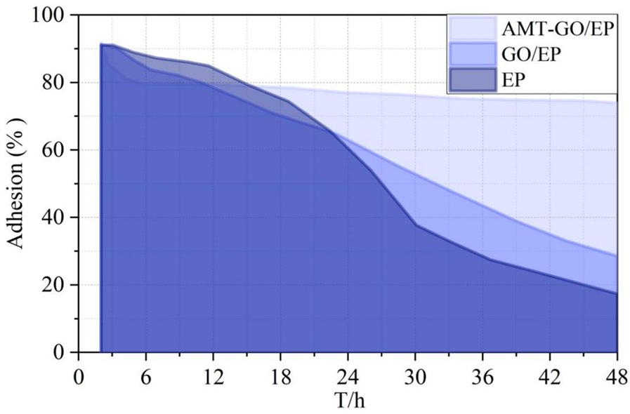

Figure 6 shows the changes in adhesion of three different coatings during the experiment. Over the 48-hour adhesion test period, the adhesion of the AMT-GO/EP organic coating decreased from a high of 91.74% to 73.95%, the GO/EP coating adhesion decreased from 91.32% to 28.59%, and the EP coating adhesion decreased from 91.12% to 17.36%. The change in adhesion strength of the AMT-GO/EP organic coating was only a decrease of 17.79%, significantly lower than the 62.73% and 73.76% decreases observed in the comparison coatings. Therefore, the AMT-GO/EP organic coating exhibits superior adhesion strength in corrosive environments, enabling it to adhere more effectively to metal surfaces and enhance metal protection performance.

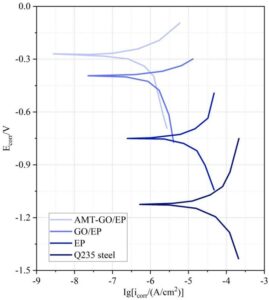

3.3.3 Analysis of polarization performance at room temperature
The corrosion potential (E\({}_{corr}\), V) and corrosion current density (i\({}_{corr}\), A/cm\(^2\)) of each sample were determined using electrochemical analysis software. Generally, lower i\({}_{corr}\) and higher E\({}_{corr}\) indicate better corrosion resistance of the sample. Figure 7 shows the dynamic potential polarization curves of Q235 steel plates and three coated samples at room temperature (controlled at 40\(\mathrm{{}^\circ}\)C in the experimental chamber). Compared to bare Q235 steel, the i\({}_{corr}\) values of all coatings were significantly reduced, and the E\({}_{corr}\) values were higher, indicating that the coatings provide effective protective capabilities. Clearly, the AMT-GO/EP coating exhibits the highest E\({}_{corr}\) (-0.27 V) and the lowest i\({}_{corr}\) (-8.56 A/cm\(^2\)). The addition of AMT-GO coating further enhances the corrosion resistance of the AMT-GO/EP coating at room temperature, providing better protection for the metal.

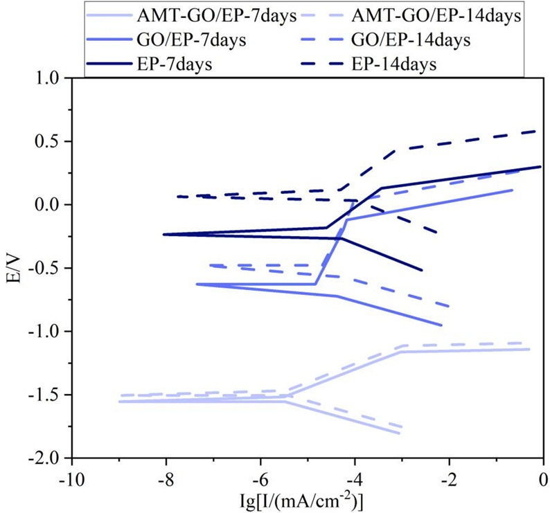

3.3.4 Comparison of polarization performance in room temperature salt water
Figure 8 shows the changes in self-corrosion potential and self-corrosion current density over time for the three coatings immersed in saltwater at room temperature for 14 days. It can be observed that, as time progresses, the potentials of all three coatings exhibit a positive shift. Under the same conditions, the more positive the potential, the greater the inertness of the coating. The potential shift for AMT-GO/EP is 0.05 V, for GO/EP it is 0.15 V, and for EP it is 0.3 V. AMT-GO/EP has the smallest potential shift, the lowest corrosion rate, and the current density remains the lowest throughout the time period. This indicates that the AMT-GO/EP coating exhibits the best corrosion resistance polarization performance in room-temperature saltwater.

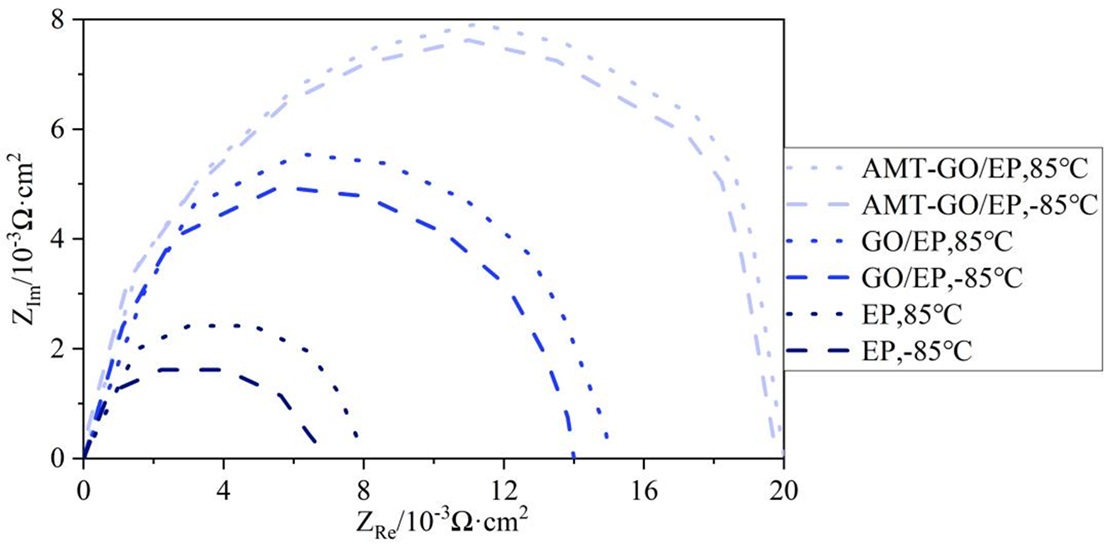

Figure 9 shows the impedance spectra of the three coatings after immersion in ultra-low temperature salt water at [-85\(\mathrm{{}^\circ}\)C, 85\(\mathrm{{}^\circ}\)C]. The larger the arc, the stronger the corrosion resistance of the coating. After undergoing multiple rapid temperature drops in ultra-low temperature durability testing, the AMT-GO/EP coating exhibited the largest arc, with values approaching 0–20 \(\mathrm{\times}\) 10\({}^{-3}\) \(\Omega\)·cm\(^2\) in the horizontal direction and 0–8 \(\mathrm{\times}\) 10\({}^{-3}\) \(\Omega\)·cm\(^2\) in the vertical direction. Additionally, the amplitude of the arc fluctuations remained very small under rapid temperature changes. This indicates that the AMT-GO/EP coating exhibits superior impedance performance in ultra-low-temperature saltwater compared to the reference coating, providing stronger protective effects on metal surfaces.
