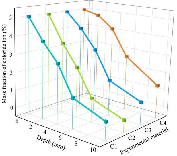

4.1.1 Chloride ion resistance
The changes in chloride ion resistance of four types of anti-corrosion coatings on concrete in a chloride ion environment are shown in Figure 1.
As shown in Figure 1, the chloride ion content decreases rapidly with increasing concrete depth. In the case of (C4) MN-1 corrosion-resistant coating, the chloride ion content on the concrete surface is 5.0%. When the concrete depth is 2 mm, the chloride ion content is 4.79%, and when the concrete depth is 4 mm, the chloride ion content is 4.08%. In contrast, the chlorine ion corrosion resistance of concrete containing MN-2 to MN-4 coatings is significantly stronger overall. Among the three coatings, the MN-3 corrosion-resistant coating provides the strongest improvement in concrete chlorine ion corrosion resistance, followed by the MN-4 coating, with the MN-2 coating being the weakest. When the concrete depth is 10 mm, the chloride ion content in (C1) MN-4 corrosion-resistant coating concrete is 0.54%, in (C2) MN-3 corrosion-resistant coating concrete is 0.31%, and in (C3) MN-2 corrosion-resistant coating concrete is 0.78%.

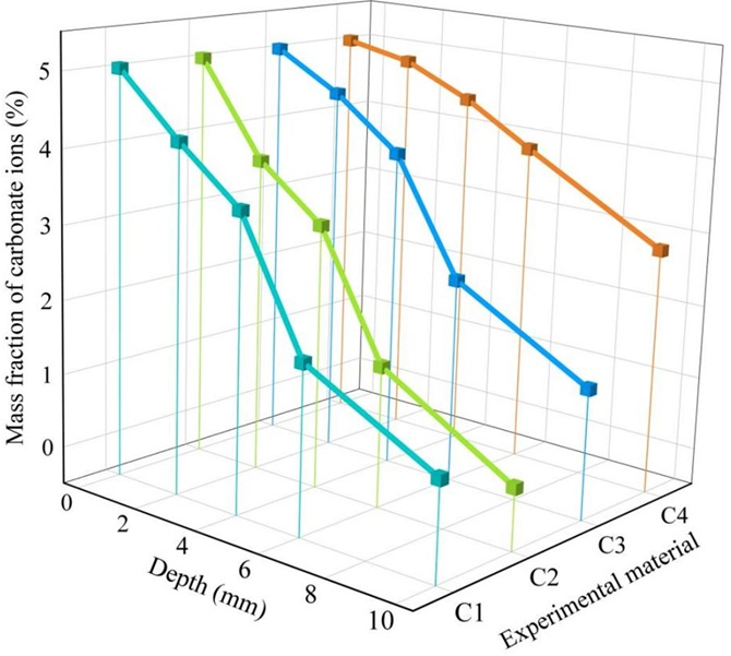

4.1.2 Resistance to sulfate ions
Figure 2 shows the changes in the sulfate resistance of four types of anti-corrosion coatings on concrete in a sulfate ion environment.
Similar to the chloride ion environment, as the depth of the concrete increases, the sulfate ion content decreases rapidly. In the case of the (C4)MN-1 corrosion-resistant coating, the sulfate ion content at the concrete surface reaches 5.00%. When the concrete depth is 2 mm, the sulfate ion content is 4.93%. When the concrete depth is 4 mm, the sulfate ion content is 4.62%. The remaining three corrosion-resistant coatings exhibit stronger resistance to sulfate ion corrosion. When the concrete depth is 10 mm, the sulfate ion content in concrete treated with (C1)MN-4 corrosion-resistant coating is 1.56%, the sulfate ion content of (C2)MN-3 corrosion-resistant coating concrete was 1.18%, and the sulfate ion content of (C3)MN-2 corrosion-resistant coating concrete was 1.94%. This is because the three corrosion-resistant coatings form a water-repellent molecular layer on the concrete surface and pore walls, which does not block the pores, thereby maintaining the original permeability of the concrete structure and enhancing its durability against sulfate ion corrosion.
Overall, the performance ranking of the four corrosion-resistant coatings in terms of concrete resistance to sulfate ion erosion is consistent with their resistance to chloride ions: MN-3 corrosion-resistant coating \(\mathrm{>}\) MN-4 corrosion-resistant coating \(\mathrm{>}\) MN-2 corrosion-resistant coating \(\mathrm{>}\) MN-1 corrosion-resistant coating.

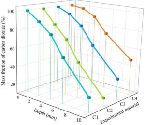

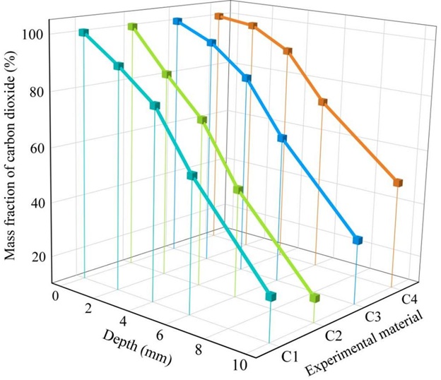

4.1.3 Resistance to carbon dioxide
Figure 3 shows the changes in the carbonation resistance of four types of anti-corrosion coatings on concrete in a carbon dioxide environment.
In a carbon dioxide environment, the concentration of carbon dioxide decreases rapidly as the depth of the concrete increases. In the case of (C4)MN-1 corrosion-resistant coating, when the depth of the concrete is 0 mm, the carbon dioxide concentration at the concrete surface is 100%. When the depth of the concrete is 2 mm, the carbon dioxide concentration is 97.58%. When the depth of the concrete increases to 4 mm, the carbon dioxide concentration decreases to 90.28%. When the concrete depth is 10 mm, the carbon dioxide ion content in (C1)MN-4 corrosion-resistant coating concrete is 25.69%, in (C2)MN-3 corrosion-resistant coating concrete it is 17.77%, and in (C3)MN-2 corrosion-resistant coating concrete it is 31.88%. These three corrosion-resistant coatings utilize the permeability of the concrete surface to penetrate into the concrete interior, where they undergo in-situ reactions to form a solidified mass, filling the capillary pores and micro-cracks within the concrete, thereby enhancing the concrete’s durability against carbon dioxide erosion.
Except for MN-1, the other three corrosion-resistant coatings form a dense corrosion-resistant layer on the concrete surface, preventing harmful substances from penetrating into the concrete interior, thereby enhancing the concrete’s durability against chloride ion corrosion. MN-1, as a classic three-layer coating system, is susceptible to the influence of the testing environment, and once the topcoat’s self-protective function fails, the coating system is prone to damage, resulting in its corrosion resistance being significantly inferior to that of the other three corrosion-resistant coating systems. Although MN-2 and MN-1 are both classic three-layer coating systems, MN-2 contains a fluorocarbon topcoat suitable for long-term use in high-temperature and high-humidity environments, featuring F-C chemical bonds and strong stability, resulting in overall performance superior to MN-2 corrosion-resistant coatings. Although the composition of the MN-3 corrosion-resistant coating system is identical to that of the MN-2 corrosion-resistant coating, the fluorocarbon topcoat formulation has been specially adjusted for high-temperature and high-humidity environments, making its corrosion resistance the best among the four coatings. The MN-4 corrosion-resistant coating uses water as the dispersing medium, offering higher safety and overall corrosion resistance superior to traditional MN-1 and MN-2 coatings, making it an environmentally friendly coating. In summary, the three corrosion-resistant coatings MN-2 to MN-4 all demonstrate a significant improvement in the concrete’s resistance to chloride ion, sulfate ion, and carbon dioxide corrosion.

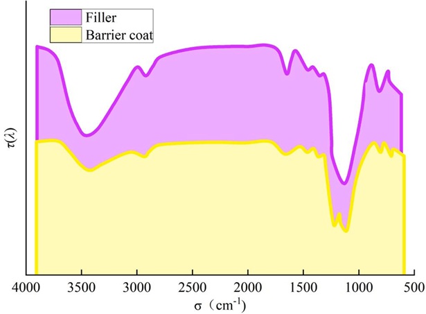

4.2.1 Chemical composition
The infrared spectra of the closed coating and filler are shown in Figure 4. The sealed coating exhibits absorption peaks of varying intensities at approximately 3469, 2907, 1666, 1213, 1157, and 1104 cm\(^{-1}\). Among these, the absorption peaks at 3469, 2907, 1666, and 1104 cm\(^{-1}\) overlap with those of the filler, indicating that these peaks originate from the filler. The absorption peak at 1213 cm\(^{-1}\) in the sealed coating can be attributed to the C-F bonds in the modifier trifluoropropanol and the binder hexafluorobutyl acrylate. The presence of fluorine-containing groups effectively reduces the surface energy of the coating. The absorption peak at 1157 cm\(^{-1}\) is caused by the vibration of Si-O-Si bonds formed by the hydrolysis of TEOS. Its formation indicates that TEOS has been completely hydrolyzed, which further increases the roughness of the coating.

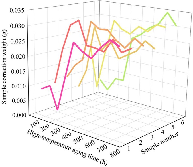

4.3.1 Weight changes in accelerated aging sealant coatings under different conditions

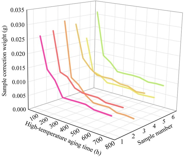

1) High-temperature accelerated aging test . Test the weight loss of samples during the high-temperature aging test cycle. The test uses a balance with a precision of 0.001 g to measure the weight loss. Measurements are taken at intervals of 60\(\mathrm{{}^\circ}\)C for 72 hours (6 days). To ensure the accuracy of the test, the balance must be calibrated with weights before each group of samples is measured. Before weighing, the samples are placed in an indoor environment at 20\(\mathrm{{}^\circ}\)C with relative humidity of approximately 60% and left to rest for 12 hours to recover. The changes in sample weight under high-temperature aging are shown in Figure 5.
The weight changes of the six sample groups were all relatively small, around 0.025 g, and the weight loss trend remained consistent. During the first measurement cycle (60\(\mathrm{{}^\circ}\)C, 72 hours), the weight loss of the coated samples was significant (approximately 0.01 g), primarily due to mass loss caused by the evaporation of the liquid components of the composite coating. Around the aging time of (60\(\mathrm{{}^\circ}\)C, 300 hours), the sample weights no longer changed. Overall, under high-temperature aging test conditions, the weight state of the sealer coating material designed in this study remains relatively stable.

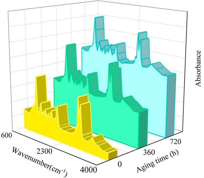

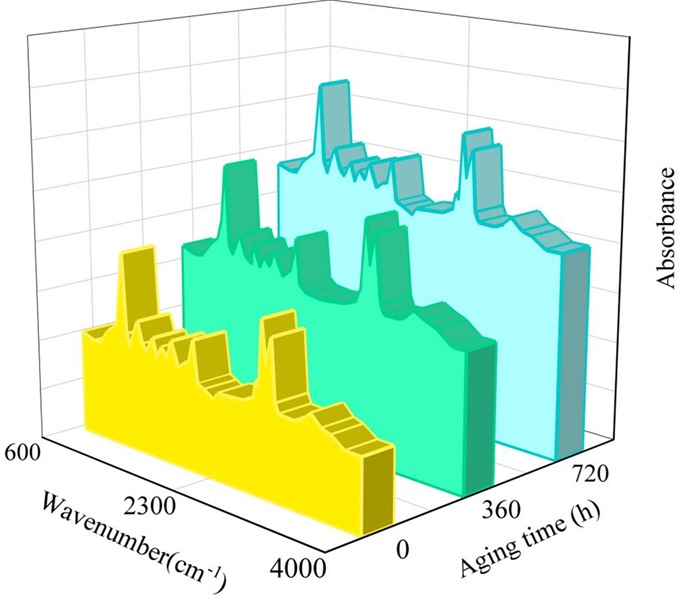

4.3.2 FTIR analysis of sealing agent coating
To assess changes in the internal properties of the sealing agent material under artificially accelerated aging conditions, Fourier transform infrared spectroscopy (FTIR) was used to test samples exposed to high temperatures and humidity. The accelerated aging sealing agent coating samples were peeled off from the glass substrate surface, cut into 10\(\mathrm{\times}\)10 mm² test specimens, and tested using ATR-FTIR (Atomic Transmission Fourier Transform Infrared Spectroscopy). The high-temperature aging FTIR spectrum after baseline correction is shown in Figure 7, and the humid heat aging FTIR spectrum is shown in Figure 8.
As shown in Figures 7 and 8, the broad peak at 3319 cm\(^{-1}\) is attributed to the stretching vibration of hydroxyl (-OH) groups in the sealer coating. The absorption peaks at 2947 cm\(^{-1}\) and 2857 cm\(^{-1}\) correspond to the stretching vibrations of methyl (-CH\(_3\)) and methylene (-CH\(_2\)) groups in the water-based coating. The absorption peak at 1720 cm\(^{-1}\) is attributed to the C=O stretching vibrations in the acrylic structure of the coating, while the peak at 1542 cm\(^{-1}\) corresponds to the C=C stretching vibrations in the acrylic resin of the coating. The absorption peaks in the range of 1037 cm\(^{-1}\) to 1284 cm\(^{-1}\) are caused by the stretching vibrations of the C-F bonds in the fluorocarbon components, and the absorption peak at 782 cm\(^{-1}\) is attributed to the \(\gamma\) phase of PVDF.
Additionally, it can be observed that the molecular framework of the material has not undergone significant changes. The absorption peaks have not shifted toward the red or blue ends of the spectrum, no new absorption peaks have formed, and the intensity of the absorption peaks has not undergone significant changes. This indicates that no significant cross-linking chemical reactions have occurred within the material. After 60 days of cyclic aging, the chemical properties of the polymer coating prepared in this study have not undergone significant changes, and the coating has not experienced destructive failure.
