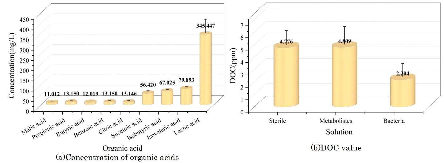

3.1 Bacterial growth characteristics
To further verify the potential of sulfate-reducing bacteria (SRB) to generate acidic substances in a condensate simulation fluid, the concentration of organic acids in the bacterial culture medium was analyzed after 7 days of incubation. As illustrated in Figure 1(a), SRB cells actively produced a range of organic acids in the simulated condensate solution—including lactic acid, isovaleric acid, isobutyric acid, and succinic acid, among others. The total concentration of these organic acids exceeded 500 mg/L, clearly indicating that organic acid production through bacterial metabolism was the primary reason for the observed decrease in the pH value of the culture medium. Furthermore, dissolved organic carbon (DOC) levels were compared across various solutions to provide a comprehensive assessment. Figure 1(b) shows that after 7 days of constant-temperature incubation, the DOC values of both the sterile condensate water simulation solution and the bacterial metabolite solution were nearly the same. However, the DOC value in the condensate water simulation solution inoculated with SRB dropped to only 2.204 ppm, which was markedly lower than those observed in the sterile and metabolite groups where no bacterial growth occurred. This significant reduction demonstrates that SRB cellular respiration has a direct impact on the DOC of the solution, with the consumption of oxygen during bacterial activity leading to a noticeable decrease in DOC values over time.

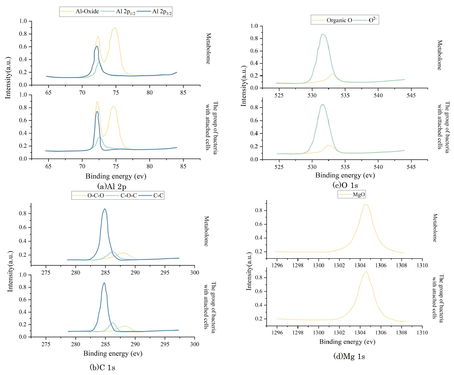

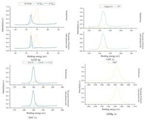

3.2.1 XPS analysis
To thoroughly investigate the metabolic activity of sulfate-reducing bacteria (SRB) and to further understand the influence of bacterial cells on the surface composition and chemical state of the protective coating, X-ray photoelectron spectroscopy (XPS) testing and analysis were performed on the surfaces of two groups of coating samples following seven days of immersion under experimental conditions. The detailed results of the XPS analysis are presented in Figure 2, and primarily include high-resolution spectra for Al 2p, C 1s, O 1s, and Mg 1s. It is evident from the data that the Al 2p high-resolution spectra for both groups are quite similar, indicating the presence of both metallic aluminum and various aluminum oxides on the surfaces. Additionally, the high-resolution spectra of C 1s, O 1s, and Mg 1s in the two sample groups also display similar peak patterns and distributions, although there are some noticeable differences in the origins of the organic elements present. The detection of carbon and its associated organic groups in these samples can be attributed not only to the components of the culture medium itself, but, more importantly, to the adsorption and accumulation of metabolic products produced by SRB on the metal surface, as well as to the development of bacterial biofilms. This suggests that the activity of SRB significantly impacts the chemical composition and surface properties of the coatings during immersion.

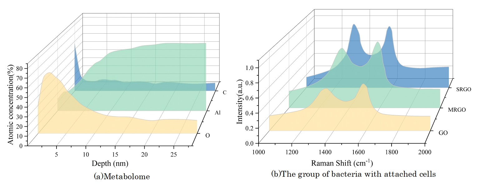

3.2.2 AES analysis
To further assess the effects of bacterial metabolic activity and cell adhesion on the thickness of the oxide film on the coating surface, AES sputtering analysis was performed on the surfaces of coating samples immersed under two different conditions for seven days. The depth distribution of major elements with sputtering depth is shown in Figure 3(a–b), primarily including the depth distribution curves of O, Al, and C elements. The depth distribution patterns of major elements on the surfaces of coating samples under different immersion conditions are similar. As the sputtering depth increases, the atomic concentration of O initially increases rapidly to a maximum value, then continues to decrease until it reaches the aluminum substrate interface, after which it begins to stabilize. The atomic concentration of Al increases overall with increasing sputtering depth until it reaches the vicinity of the aluminum substrate, after which it begins to stabilize at a basic level. The atomic concentration of C decreases continuously from the start of sputtering until it stabilizes at a low level.
The sputtering depth at which the atomic concentration of oxygen is reduced to half of the surface value of the sample is typically assessed as the thickness of the oxide film. Based on the above method, the average thickness of the surface oxide film in the metabolite group samples was determined to be approximately 9.734 nm, while the average thickness of the surface oxide film in the bacterial group samples with attached cells decreased to approximately 7.256 nm. AES data from the coating surface under different immersion conditions indicate that the acidic metabolites produced by SRB and the SRB cells attached to the surface cause the oxide film on the coating surface to thin.
The above AES analysis results indicate that SRB promotes the thinning of the oxide film on the coating surface by producing acidic metabolites and cell adhesion in the condensate simulation fluid. This will affect the distribution and integrity of the oxide film, thereby affecting the protective performance of the oxide film on the aluminum substrate.

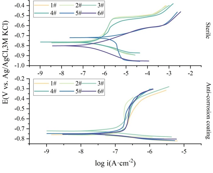

To characterize the corrosion rate of the system, dynamic polarization was employed. The dynamic polarization curves for different groups are shown in Figure 4, and the fitting results of the polarization curves are presented in Table 1. Due to passivation phenomena in the anodic branches of some electrodes, the cathodic branches were selected for fitting. The coating group formed a FeS protective film, resulting in a smaller corrosion current compared to the sterile condition. The i\({}_{corr}\) values of electrodes 1–5 with the coating removed ranged from 0.038 to 0.193 \(\mu\)A·cm\(^{-2}\), while the i\({}_{corr}\) value of electrode 6 with the coating removed was significantly lower than that of the sterile electrode 6, at 0.038 \(\mu\)A·cm\(^{-2}\), demonstrating that the introduction of the corrosion-resistant coating in the system has a certain protective effect.
Table 1 The fitting result of the polarization curve
Electrode E\({}_{corr}\)(mV) i\({}_{corr}\)(\(\mu\)A·cm\({}^{-2}\)) b\({}_{c}\)(mV·dec\({}^{-1}\))
Sterile 1# -797 0.397 -91.186
2# -784 0.359 -90.373
3# -808 0.304 -84.416
4# -799 0.106 -70.362
5# -745 0.455 -96.017
6# -834 1.118 -72.118
Anti-corrosion coating 1# -776 0.193 -35.028
2# -780 0.125 -20.375
3# -723 0.048 -36.196
4# -761 0.042 -32.915
5# -755 0.039 -59.371
6# -759 0.038 -80.037

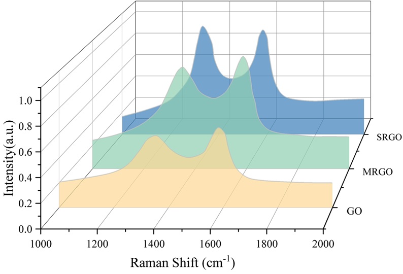

3.4.1 Reduction of GO by SRB
Raman scattering is a tool for characterizing the disordered nature of carbon materials and was used in this study to monitor the reduction process of GO. The Raman spectra of different samples are shown in Figure 5. GO primarily exhibits two distinct characteristic peaks, known as the D peak and G peak. After reduction, the D peaks of MRGO and SRGO shift to 1366 cm\(^{-1}\) and 1351 cm\(^{-1}\), respectively, while the G peaks shift to 1615 cm\(^{-1}\) and 1603 cm\(^{-1}\), respectively, all of which are lower than the peak positions of GO, indicating the reduction process. The degree of structural disorder is characterized by the ratio of the intensities of the D peak to the G peak. The I\({}_{D}\)/I\({}_{G}\) value of GO is 0.93, while the I\({}_{D}\)/I\({}_{G}\) values of MRGO and BRGO gradually increase to 0.96 and 1.15, respectively, after reduction. After reduction, a large number of sp³-hybridized carbon atoms in GO lose their oxygen-containing groups to form sp\(^{2}\)-hybridized carbon atoms. However, the newly formed sp\(^{2}\) regions are smaller in size than the sp³ regions in GO. This results in a smaller average sp\(^{2}\) region size in BRGO, increased fragmentation of GO, an increase in the number of fragments, and an increase in defect density, leading to an enhanced I\({}_{D}\)/I\({}_{G}\) value.

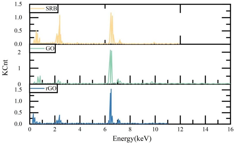

3.4.2 Biofilm morphology
The EDS elemental analysis results of SRB biofilms and corrosion products on the sample surface under different conditions are shown in Figure 6. When only SRB is present, the sulfur (S) content in the corrosion products is the highest, reaching 8.95%, which is produced by SRB metabolism. After adding GO and rGO, the S element content in the characteristic corrosion products of SRB decreases significantly, to 2.42% and 3.16%, respectively, indicating that SRB metabolic activity is inhibited. The content of elements such as C and N also decreased, which is related to the reduction in biofilm. However, the C content significantly increased, primarily due to the coverage of rGO. These results indicate that the addition of GO and rGO can reduce the content of SRB-specific corrosion products, inhibit their growth, and reduce the adhesion of biofilms on carbon steel surfaces.

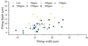

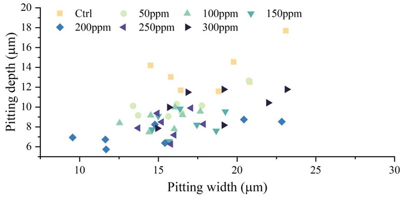

3.4.3 Pitting distribution
After adding rGO at different concentration gradients, the depth and width of seven pitting corrosion pits on the sample surface were measured, with the results shown in Figure 7. When only SRB was present, the depth and width of the pitting corrosion pits on the carbon steel surface were the largest, with a maximum depth of 17.7 \(\mu\)m and a maximum width of 23.1 \(\mu\)m, and the pitting corrosion pit depths were primarily concentrated between 11 and 14 mm. After adding different concentration gradients of GO, both the depth and width of the pitting corrosion pits on the carbon steel surface decreased, indicating that adding rGO can reduce the depth and width of the pitting corrosion pits caused by SRB on the carbon steel surface. The effect of mitigating pitting corrosion is related to the amount of rGO added. When the rGO addition was 200 ppm, the effect was optimal, with a maximum pitting corrosion pit depth of 8.5 mm and a width of 22.8 mm.

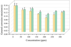

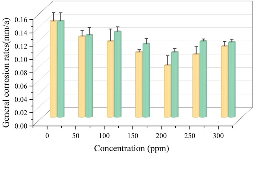

3.4.4 Uniform corrosion rate
The uniform corrosion rates of the specimens in the SRB medium under different conditions are shown in Figure 8. When only SRB is present, the uniform corrosion rate of carbon steel is the highest, at 0.144 mm/a. After adding GO and rGO, the uniform corrosion rates of carbon steel gradually decrease. When the addition levels of GO and rGO were both 200 ppm, the uniform corrosion rate of carbon steel was the lowest, at 0.078 mm/a and 0.097 mm/a, respectively, indicating that GO and rGO can mitigate SRB corrosion on carbon steel, consistent with the pitting corrosion data results. However, when the addition levels of GO and rGO exceeded 200 ppm, the uniform corrosion rate increased with increasing addition levels.

  1. The total concentration of various organic acids produced by SRB cells in the condensate water simulation solution exceeds 500 mg/L. The production of organic acids by bacterial metabolism is the direct cause of the decrease in pH value of the bacterial culture medium. The DOC values of sterile condensation water simulation solution and bacterial metabolite solution are basically the same. The DOC value of condensation water simulation solution inoculated with SRB is only 2.204 ppm, indicating that SRB cell respiration affects the DOC of the solution. Bacterial respiration consumes oxygen, leading to a decrease in the DOC value of the solution.

  3. When the addition of rGO is 200 ppm, the effect is optimal, with a maximum pitting depth of 8.5 mm and a width of 22.8 mm. When both GO and rGO are added at 200 ppm, the uniform corrosion rate of carbon steel is minimal, at 0.078 mm/a and 0.097 mm/a, respectively.
