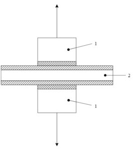

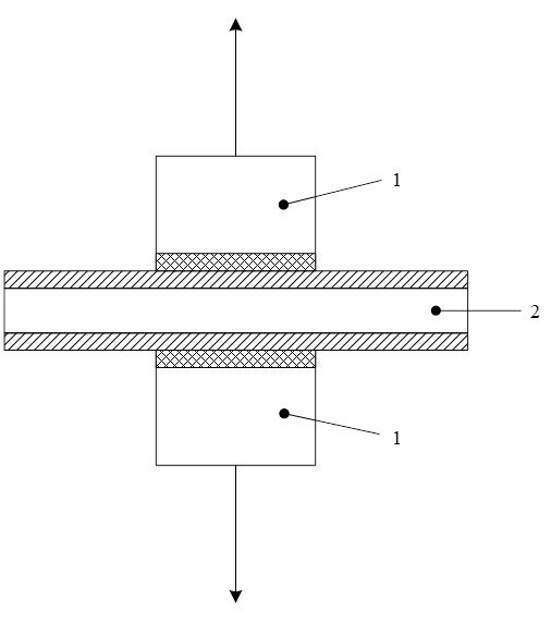

  2. Tensile testing machine. Electronic universal testing machine with a range of 0–75 kN, accuracy grade 0.1, and tensile speed not exceeding 1.5 MPa/s.
  3. Test columns. Steel cylindrical bodies with a diameter of 25 mm and a height of 50 mm. One end of the test column has a hard, flat surface bonded with adhesive/coating, with its plane perpendicular to the axis of the test column, while the other end is equipped with a device for connecting to the tensile testing machine.
  4. Test procedure. A universal test method applicable to both hard and deformable substrates is used (using two test columns). The adhesive is uniformly applied to the surfaces of two clean, identical-diameter test columns. The test specimen is placed between the two adhesive-coated surfaces of the test columns, with the columns centered and coaxially aligned relative to the specimen. The test assembly for a sandwich test on a double-coated substrate is shown in Figure 1, where “1” denotes the test column coated with adhesive and “2” denotes the double-coated substrate.
    The test assembly is placed in a centering device and maintained in a coaxial arrangement during the adhesive curing period. After curing, use a cutting device to cut through the test columns along their circumferential lines to the substrate. Place the test assembly in a centering device and maintain the coaxial alignment during the adhesive curing period. After curing, use a cutting device to cut through the test columns along their circumferential lines to the substrate. Place the test assembly in a tensile testing machine, carefully center the test columns to ensure that the tensile force is uniformly applied to the test area without any twisting. Apply tensile stress perpendicular to the painted substrate plane, increasing the stress at a rate not exceeding 1.5 MPa/s. The failure of the test assembly should occur within 75 seconds of stress application. Record the tensile force at failure. Conduct at least seven measurements, using at least seven test assemblies.

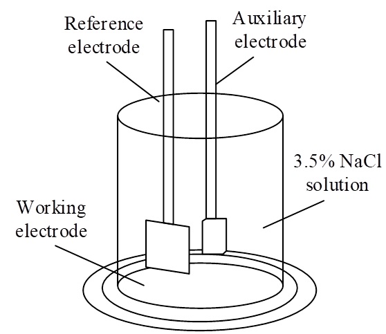

Electrochemical testing primarily includes open-circuit potential testing, electrochemical impedance spectroscopy testing, and dynamic potential polarization curve testing. This paper uses an electrochemical workstation of a certain model produced by a certain company for electrochemical testing. The electrochemical experiments were conducted using a three-electrode system, whose structure is shown in Figure 2, consisting of a working electrode (WE), a reference electrode (RE), and an auxiliary electrode (AE). The WE is a Q345 low-carbon steel plate coated with a coating, with an exposed area of 0.8 cm² during testing. The RE is a saturated calomel electrode (SCE), and the AE is a platinum sheet electrode. The electrolyte is a 4.3 wt% NaCl solution.
1) Open-circuit potential (OCP) testing. Open-circuit potential (OCP) reflects the extent of corrosion tendency and is one of the key methods for analyzing the corrosion resistance of coatings. Before testing OCP, the steel plate coated with the coating should be immersed in a NaCl solution for a certain period of time. Once the system has stabilized, the test should be conducted, and the change curve of OCP with increasing immersion time should be recorded. Each sample group should undergo three tests to ensure the reliability of the experimental results.
2) Electrochemical impedance spectroscopy (EIS) testing. EIS is an important research method for analyzing the corrosion resistance of anti-corrosion coatings, as it reflects the corrosion behavior occurring within the coating. Before conducting EIS testing, the OCP curve as a function of time should be measured. Once the OCP has stabilized, EIS testing should be performed at that OCP value. The amplitude of the sinusoidal voltage signal is 30 mV, and the testing frequency range is 10\(^{-2}\) Hz to 10\(^{5}\) Hz. EIS test results include Nyquist plots and Bode plots. The test results are fitted using ZView software, and an appropriate equivalent circuit is selected based on the test results to obtain relevant electrochemical parameters.

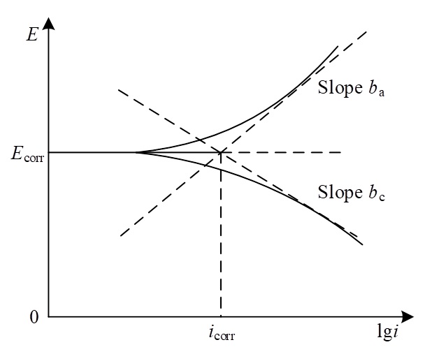

3) Dynamic polarization curve testing. Tafel polarization curves are typically measured at the end of the immersion process and after other electrochemical tests have been completed. The Tafel curve is measured at a scan rate of \(1.5{\rm mVs}^{-1}\) within the range of -220 mV to 220 mV near the open-circuit potential (OCP). The Tafel extrapolation method, as shown in Figure 3, is used to calculate the dynamic potential polarization parameters, including the anodic slope \(\left(b_{a} \right)\), cathodic slope \(\left(b_{c} \right)\), corrosion potential \(\left(E_{corr} \right)\), and corrosion current density \(\left(i_{corr} \right)\). The polarization resistance \(\left(R_{p} \right)\) and protection efficiency \(\left(PE\right)\) are calculated using Eqs. (1) and (2).
\[\label{GrindEQ__1_} \frac{I}{R_{p} } =2.303\times \left(\frac{b_{c} \times b_{c} }{b_{a} +b_{c} } \right)\times i_{corr} , \tag{1}\] \[\label{GrindEQ__2_} PE={\left(i_{corr}^{EP} -i_{corr} \right)\mathord{\left/ {\vphantom {\left(i_{corr}^{EP} -i_{corr} \right) i_{corr}^{EP} }} \right. i_{corr}^{EP} } \times 100\% . \tag{2}\]

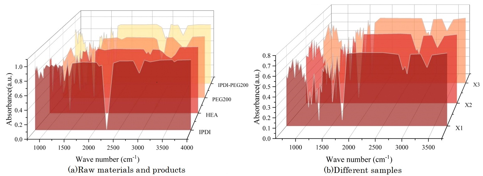

Taking the X1 coating as an example, the infrared absorption spectra of the raw materials and products are shown in Figure 4(a). The strong and sharp vibrational absorption peak at 2244 cm\(^{-1}\) is characteristic of the -NCO group in IPDI. The broader vibrational absorption peaks observed at 3549 cm\(^{-1}\) for PEG200 and at 3410 cm\(^{-1}\) for HEA are characteristic of the -OH groups in their molecular structures. Due to stronger hydrogen bonding interactions between HEA molecules, its -OH characteristic peak shifts toward lower wavenumbers. In the infrared absorption spectrum of HEA, the vibrational absorption peaks at 1635 cm\(^{-1}\) and 1052 cm\(^{-1}\) correspond to the stretching vibration of the C=C double bond and the bending vibration of the C-H bond on the double bond, respectively. In the infrared absorption spectrum of the product IPDI-PEG200, the characteristic absorption peak of the -NCO group at 2244 cm\(^{-1}\) disappears, and a sharper -NH absorption peak appears at 3341 cm\(^{-1}\), which is more pronounced than the -OH absorption peak. This indicates that the -NCO group reacted with the -OH group to form an urethane bond. Additionally, characteristic peaks of the double bond were observed at 1635 cm\(^{-1}\) and 1052 cm\(^{-1}\) in the product, indicating successful capping with HEA. The infrared absorption spectra of all corrosion-resistant coating samples on metal surfaces are shown in Figure 4(b), where the characteristic peak of the -NCO group at 2244 cm\(^{-1}\) has disappeared, and the characteristic absorption peak of the -NH group at 3341 cm\(^{-1}\) has appeared. Additionally, the characteristic peaks of the double bond at 1635 cm\(^{-1}\) and 1052 cm\(^{-1}\) are also observed.

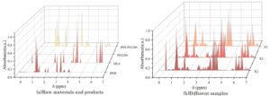

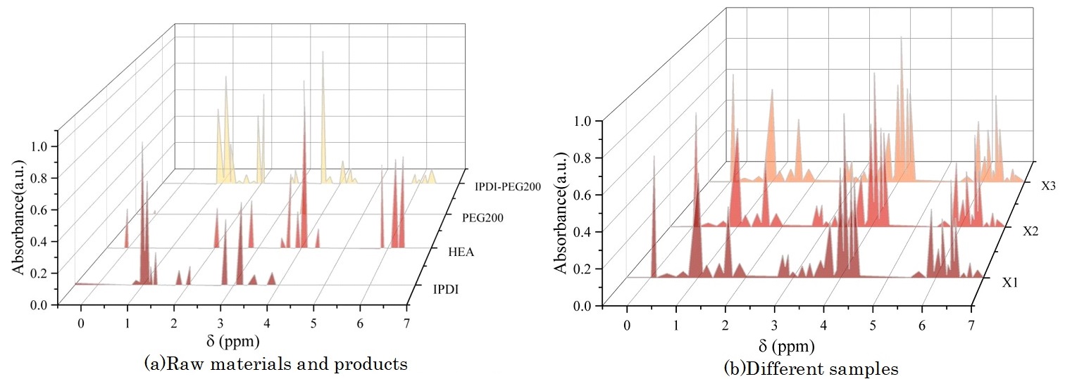

3.2.2 Hydrogen nuclear magnetic resonance spectrum
The hydrogen nuclear magnetic resonance spectra of the raw materials and products of the X1 coating sample are shown in Figure 5(a). The proton peaks at 0.8–2.1 ppm correspond to the H atoms of the methyl groups on the IPDI ring structure (7–15), while the proton peak at 4.0 ppm corresponds to the H atoms of the methylene groups in PEG200 (13, 14), the proton peaks at 6.0–6.7 ppm correspond to the H atoms on the acryloxy double bond in HEA (2, 3, 4), and additionally, a proton peak corresponding to the hydrogen on the urethane bond appears at 7.2 ppm. This peak is relatively weak due to the strong hydrogen bonding in the polyurethane. Overall, this confirms the successful synthesis of IPDI-PEG200. The hydrogen nuclear magnetic resonance spectra of all the corrosion-resistant coating samples synthesized in this study are shown in Figure 5(b), where the corresponding proton peaks can be observed in all cases.

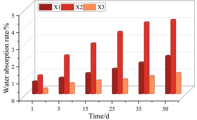

3.3.1 Water absorption rate
Metal corrosion is primarily initiated by the infiltration of water molecules. Water not only transports various corrosive agents, such as salts and acids, to the metal surface, but it also brings dissolved oxygen, which serves as a catalyst for the corrosion process. Therefore, evaluating the water absorption rate of protective coatings is fundamental for understanding their anti-corrosive mechanisms and long-term effectiveness in harsh environments. The water absorption rates for different coatings at various time intervals are illustrated in Figure 6. Among the three, the X3 coating demonstrates the lowest water absorption rate, followed by the X1 coating, while the X2 coating exhibits the highest rate. The maximum water absorption for the X3 coating is approximately 1.23%. Such a low rate suggests that the X3 coating possesses excellent waterproofing capabilities and barrier properties, thereby providing outstanding corrosion protection.
In comparison, the X1 coating, with a maximum water absorption rate of about 2.22%, generally has a greater thickness. This increased thickness helps minimize the number of through-holes caused by air bubbles within the coating matrix, thus enhancing its water resistance to a certain extent. On the other hand, the X2 coating records a significantly higher maximum water absorption rate of 4.33%. This is attributed to its incomplete internal structure, characterized by a large number of pores and defects, which allows water to penetrate more readily and compromises its protective effectiveness.
The water absorption rate of anti-corrosion coatings has a direct impact on the speed at which aggressive agents reach the underlying metal, as well as the overall corrosion resistance of the system. When the water absorption rate is high, corrosive media can more easily migrate through the coating and accelerate the corrosion of the metal substrate. Based on the experimental data, it can be concluded that metal corrosion occurs more rapidly under the X2 coating than under the X1 and X3 coatings, due to its higher water absorption and less effective barrier properties.

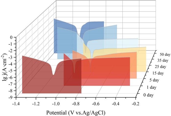

3.4.1 Polarization curve test
Based on the findings from both the comprehensive water absorption and adhesion tests, the X1 coating—demonstrating the most favorable overall properties—was selected for in-depth investigation of its corrosion resistance. To assess its durability under aggressive conditions, seven small metal specimens coated with X1 were fully immersed in a 4.3% NaCl aqueous solution to simulate a marine environment. At predetermined intervals, one specimen was extracted from the solution for electrochemical analysis, while the remainder continued immersion. The electrochemical data corresponding to each immersion period were obtained, and the polarization curves for these different exposure durations are presented in Figure 7.
As the exposure time in the saline solution increased, it was observed that the self-corrosion current density (\(i_{corr}\)) of the X1 coating initially decreased, reaching a minimum before subsequently increasing, while the self-corrosion potential (\(E_{corr}\)) exhibited the opposite trend, first increasing and then declining. A lower self-corrosion current density is indicative of a slower corrosion rate, suggesting enhanced resistance to the ingress of corrosive agents and a prolonged service life for the coating. Upon detailed comparison, it was found that the minimum self-corrosion current density occurred on the 5th day of immersion, measured at 1.875\(\mathrm{\times}\)10\(^{-6}\) A\(\cdot\)cm\(^{-2}\), which corresponds to the slowest rate of electrochemical corrosion and represents the peak corrosion resistance of the X1 coating during the test period. However, following the 5th day, the self-corrosion current density began to rise steadily, signifying that the coating was being increasingly compromised by prolonged exposure to the saline environment. This ongoing deterioration resulted in a gradual decline in the coating’s protective capabilities, and by the 35th day of immersion, significant corrosion was evident, including the formation of visible red rust on the metal substrate.

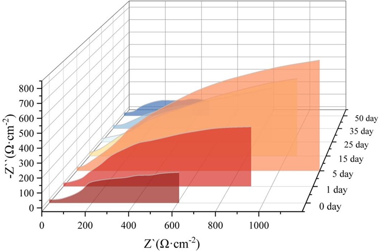

3.4.2 AC impedance spectrum testing
AC impedance spectroscopy is an electrochemical method that uses a low-amplitude sinusoidal potential as a disturbance signal to measure coating systems. The measurement results can provide detailed information about the dielectric properties of the coating and related corrosion information of the coating or metal surface. By observing the Nyquist plot of the coating, the corrosion resistance of the coating can be analyzed under varying AC frequencies. AC impedance spectroscopy tests were conducted on X1 coatings immersed in a 4.3% NaCl aqueous solution for different durations. The Nyquist plots of the coatings are shown in Figure 8. The impedance spectra of the coatings obtained after immersion in saltwater for different durations exhibit similar shapes, with corresponding Nyquist plots featuring two capacitive arcs. The small capacitive arc at high frequencies is related to the physical resistance of the coating, while the large capacitive arc at low frequencies is associated with corrosion reactions involving the zinc-aluminum powder in the coating. The impedance spectra of all coatings exhibit two time constants, indicating that the electrolyte has penetrated the coating surface and undergone electrochemical reactions. From 0 to 5 days, the amplitude of the low-frequency capacitive arc gradually increases. This is because the initial reactions produce insoluble corrosion products that cover the surface of the chromium-free zinc-aluminum corrosion-resistant coating, blocking the original corrosion pathways and preventing further corrosion of the metal powder. As corrosion time increases, the blocking effect of corrosion products on pores gradually becomes weaker than the corrosive medium’s erosion of the coating. Once the equilibrium is disrupted, more corrosion pathways are exposed, and the corrosive medium continues to intensify its erosion of the coating, resulting in a gradual decrease in the low-frequency capacitive reactance amplitude of the coating.
An AC impedance spectrum fitting circuit was used for analysis, with the fitting results shown in Table 5. In the circuit diagram used, R\({}_{s}\), R\({}_{c}\), C\({}_{c}\), R\({}_{ct}\), and C\({}_{dl}\) represent the solution resistance, coating resistance, coating capacitance, charge transfer resistance, and double-layer capacitance of the electrochemical reaction in the measurement system, respectively. The solution resistance R\({}_{s}\) of all coatings is similar, while the coating resistance R\({}_{c}\) first increases and then decreases. Additionally, the coating resistance value after 35 days of saltwater immersion is lower than that at 0 days. This change occurs because, as the coating is immersed in saltwater, the metal powder on the coating surface undergoes an activation reaction, producing insoluble corrosion products that accumulate on the coating surface and in smaller pores. Initially, the coating is strengthened, but as the corrosion time increases, this strengthening effect gradually becomes weaker than the electrochemical corrosion effect. Part of the metal powder on the coating surface is corroded and peels off, causing the coating resistance to gradually decrease. Based on the R\({}_{ct}\) results, it can be seen that from 0 to 15 days, the charge transfer resistance of the X1 coating immersed in the NaCl solution gradually increases and reaches a maximum value of 1653.85 \(\Omega\)·cm\(^{-2}\) on the 15th day. At this point, the electrochemical corrosion reaction on the coating surface is slowest, the coating is most dense, and the shielding effect is strongest, making it difficult for the corrosive medium to penetrate the coating. As the immersion time continues to increase, corrosion deepens, and the charge transfer resistance of the coating gradually decreases, dropping to 539.37 \(\Omega\)·cm\(^{-2}\) by day 50, which is below the initial value at day 0. Combined with the macroscopic morphology of the coating, it can be concluded that red rust has formed at this point, and the coating has been damaged.

Hence, the X1 coating provides excellent physical shielding protection and electrochemical corrosion protection for metal substrates. As corrosion time increases, the density of the X1 coating first increases and then deteriorates due to erosion, resulting in a rise and subsequent decline in its corrosion protection performance.
